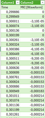

I am using steval mkboxpro with FP-SNS-DATALOG2, and after acquisition i obtained a .dat file, then i used the program that came in  FP-SNS-DATALOG2 to convert .dat to .csv, after opening the .csv i have the timestamps and waveform. Like this:
From what i understand by reading the files and your explanation, the output is a PDM, a stream os 0s and 1s, but i don't have that output. My problem is that i need to have this in db or dbSPL.
Any of the solution that you suggested is compatible with using FP-SNS-DATALOG2?
the CSV file obtained from the microphone is a PCM (pulse-code-modulated) meaning that all numbers represent the audio level. Just plot the waveform to see it.
dBSPL can be estimated only indirectly, assuming the max PCM value is corresponding to the AOP acoustic-overload-point of the microphone (see datasheet).
Anyway, if you happen to manage to get the PDM bitstream, you can easily convert to PCM. Example: PDM stream is 1bit a 3Mbps, you want PCM at 48kHz, down-sampling ratio is 64:1. You usually apply low-pass filters and down-sample in stages. First stage can be to apply a moving average with 8:1 downsampling which means subdividing the bitstream in bytes and counting the '1's in each byte. From there you have a 3bit PCM at 384kHz and you need to apply a better lowpass (IIR or FIR) to get good signal-to-noise ratio in the audio band (see design tips DT0088, DT0091, DT0092 for example).
no need to solve a problem because there is no problem: DATALOG2 saves the PCM in the .dat and you get the values of each audio sample in the .csv.

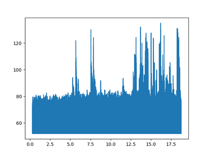

Is this right? Because i am getting higher values then expected for a room noise. I leave the logic of the code and a graphic?
waveform_col = df.columns[1]
max_val = np.max(np.abs(df[waveform_col]))
df["dBFS"] = 20 * np.log10(np.abs(df[waveform_col]) / max_val)
df["dBSPL2"] = df["dBFS"] + 135
As explained before, the formula would be a rough estimate of the dBSPL because dBFS is measuring one thing (where the signal stand with respect to full-amplitude) and dBSPL is measuring the actual physical sound pressure.
135dB AOP was an example, if you are using a specific part you should read the datasheet! for MP23DB01HP the datasheet says AOP is 120dBSPL and you should use that number, not the one in the example: dBSPL = dBFS + 120.
The datasheet says that a 94dBSPL signal at 1kHz stays at -24dBFS +/-1dB. You can use this reference point to get the number you are looking for, 118dBSPL+/-1dB at 1kHZ would correspond to 0dBFS. Which again points to dBSPL = dBFS + 118.
RMS is more reliable than an instantaneous measure. So, use the RMS of a data segment to get the same levels that an audio instrument would report (because remember audio applications use RMS).
Finally, for applications that require accuracy you can perform a 1 point calibration: create a stimulus with a precisely known dBSPL level, measure the dBFS level from the microphone and compute the offset to be added to go from one number to the other.
Keep in mind that the frequency response is not flat, signals with same dBSPL but different frequencies will appear to have different dBFS.
Hope you can move forward with your application now. If so, please mark this as solution accepted.
