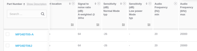

2024-08-06 7:59 PM
Can't find in datasheet, but product table states as 20 kHz
https://www.st.com/en/mems-and-sensors/mems-microphones/products.html
