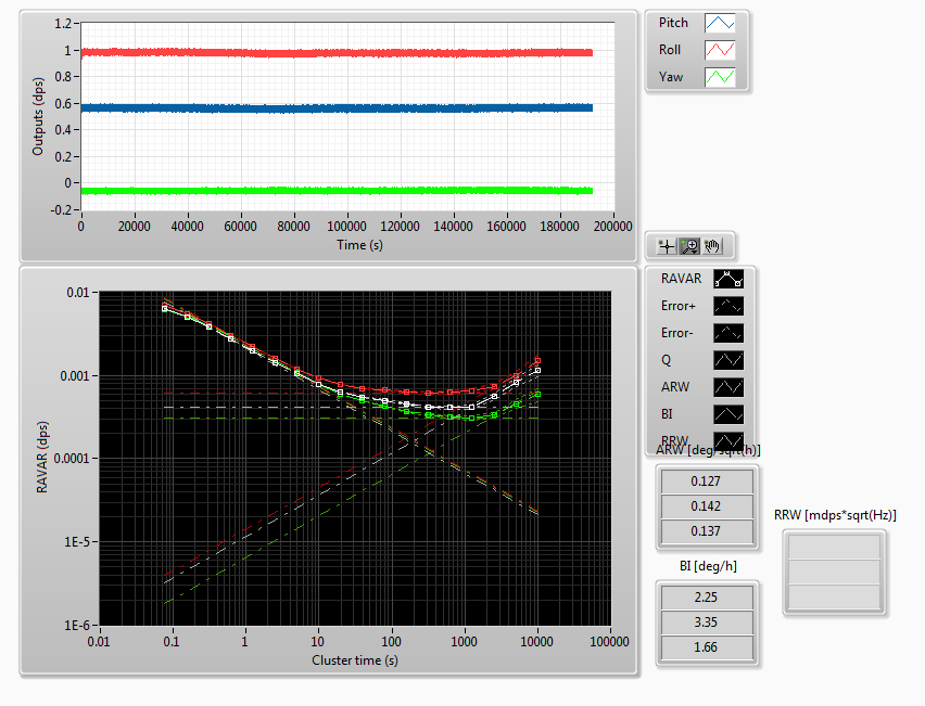

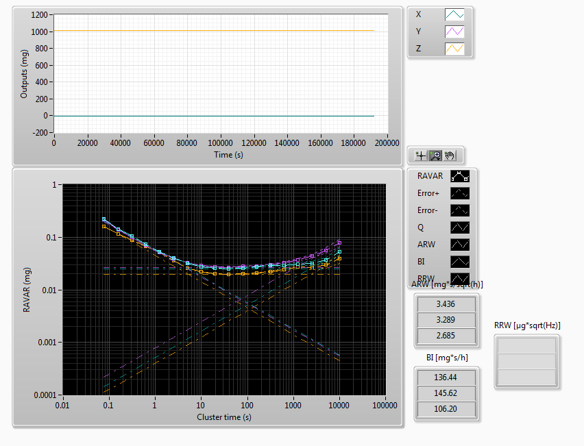

Hi @amuel.1 , the datasheet parameters are the (typically) tested ones at production level. The AVAR plot (and related parameters), and the misalignment-related specs are tested at bench / lab level. I could share you typical characterization data for the AVAR parameters, and a typical plot for the 6 axis.
where ARW = angle random walk, BI = bias instability, RRW = rate random walk.
Here below the AVAR plots for the DSOX device (1st picture for accelerometer, 2ndpicture for the gyro part):
Regards
