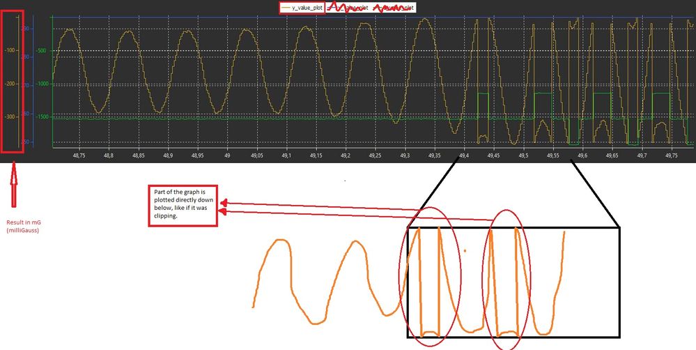

As you can see in the picture, the higher part of the sinusoid signal is getting wrecked in the highest part, but it appears in the lower part (so the information is still there).
This happens when the magnetic field is strong enough (We are putting a coil next to it generating the magnetic field)
The problem is that I (and any of the people I work with) do not think this is a big enough magnetic field for it to overflow, so that is why we are wondering if there is another problem we did not think about.

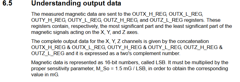

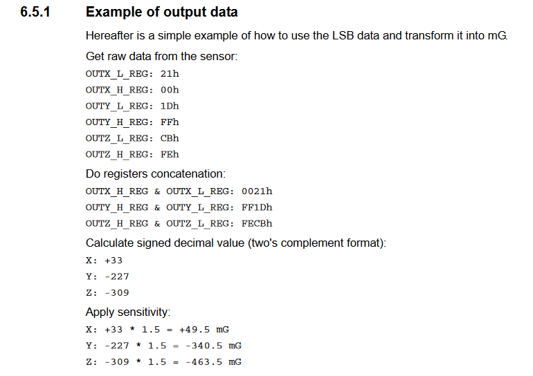

As the manufacturer suggests, the data aquired by the magnetometer should be processed as following:
and what I am doing to process it in the code is exactly that:

}The resultant wave is "clipping" because the upper part of the Y register is not changing and remains all 8bit at 1.
Also as you can see, the concatenation is performed as expected.

Looks like a mid-high bit is getting corrupted from a noise or timing issue caused by the field itself I should think.
Suggest you scope SDA and SCL preferably at a bad bit. This is where an MSO scores.
Also check whether the reads were successful.
Finally I note you're applying a varying magnetic field and that's going to induce all sorts electromagnetics and all that. I would plat or screen the sensor leads.

looks like signal is over max-limit, and >> uint16_t signed_16b is : making unsigned int signed or what ??
maybe, there is a gain setting on chip ?

Thanks for replying. I do not think it is a matter of corruption, as I think HAL_I2C_Mem_Read ensures the communication was successful.
Moreover, it seems that the high 8 bits for the x and z axis change in a very slow manner. I think it is a matter of gain as @AScha.3 mentions. Nevertheless I cannot find a register/function to change such behavior in this sensor.

Ooo : maybe you invert MSB with your confused INT - UINT castings...
so keep to signed, when value is signed !
uint16_t join_into_signed_16b...() -> int16_t join_into_signed_16b...()
if you invert MSB by (wrong ) conversion , signal looks like your signal!

Sadly the problem persists. The upper register wong change for some reason.
