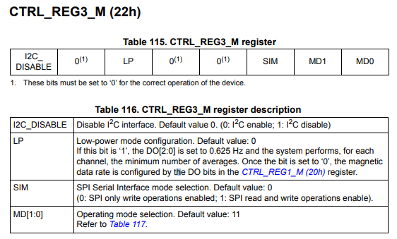

Hi Riccardo, I was supposing you were in FIFO mode, and you were decoding the data in a wrong way. Btw, are you communicating I2C or SPI? In the SPI case you should write at least '1' in the SIM bit of CTRL_REG3_M.
