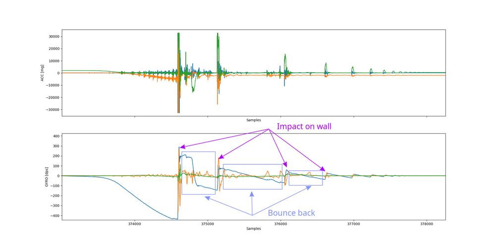

In order to examine the problem we build a simple mechanical setup and recorded some data with it:
We attached the LSM6DSV32X to a metal bar that pivots around an axle attached to a solid wall. During the recording we lifted the unrestrained end of the metal bar up and dropped it, causing it to hit the wall. After the impact of hitting the wall, the metal bar bounces back and forth a few times.
We repeated this several times over multiple recordings.

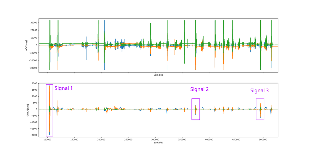

This is what the first recording looks like:
Both Signal 2 and Signal 3 look as expected with gyroscope amplitudes of around 400 dps. Here is a close up of Signal 2:
And a close up of Signal 3 (different time scaling in the plot, but very similar to Signal 2:(

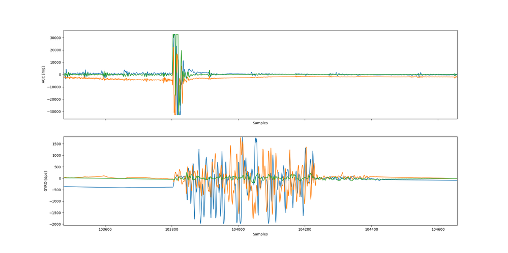

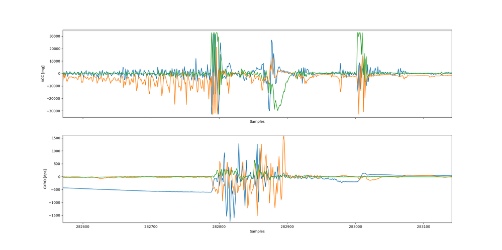

However Signal 1 looks completely different. Here the gyroscope amplitudes are close to 2000 dps and the expected patterns of impacts and bouncing back are not visible.
To be sure we did more recordings and while most of the signals looked good, there were several more signals that looked like the example above.

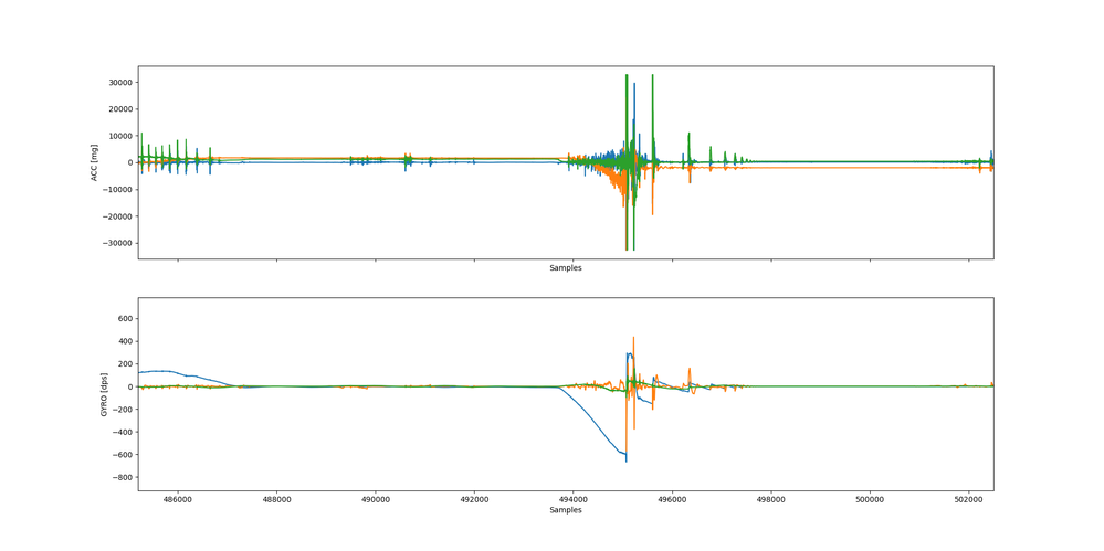

Here is another example:

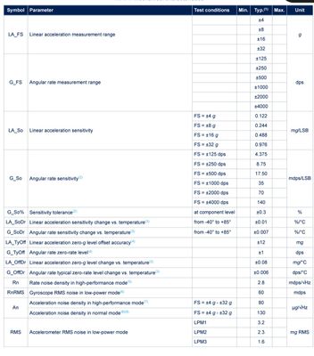

This is what the datasheet provides:
I cant find a specification for a maximum acceleration for the gyroscope.

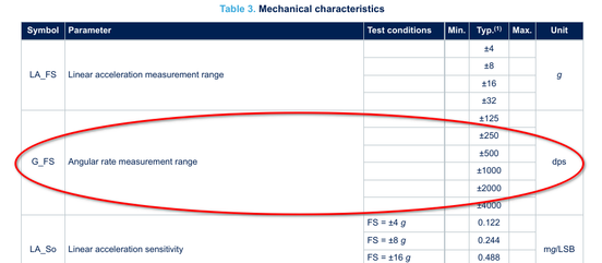

The gyroscope data you want is here -
The sampling rates would need to increase, not lower, to lessen the distortion.
This is the angular velocity measurement range of the gyroscope. In our case we set it to +/- 2000 dps.
As I wrote in my original post, the signals we were measuring have a magnitude of about +/- 400 dps, so they are well within the measurement range.
