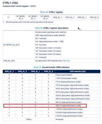

±2g is set.
I haven't done anything yet
except set CTRL1(10h) to 960Hz and read with 10mSec (100Hz) with the I2C bus (1MHz).

I can select different frequencies on the LSM6DSV16X
samplerate 15,30,60,120,240,480,960,1920,3840,7680 in Hz
can i also sample these at slightly higher frequencies?
960=>1000
1920=>2000
3840=>4000
7680=>8000

You can sample at 1000, 2000, 4000, 8000Hz.
As mentioned above: enable HA-ODR mode (high-accuracy ODR more) - see AN5763 section 3.1 page 18, table 11. You have 3 sets of ODR available: multiples of 15Hz, multiples of 15.625Hz, and multiples of 12.5Hz.
The option in the middle is what you need: as you see in table 11!
