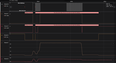

I've been trying to use the LSM6DSV on it's steval-mki239a board with a nucleo board (nucleo-l476rg) via SPI and the lsm6dsv is not answering whatever the configuration of my SPI is.
The sensor is fine since it work with the steval-mki109v3 board ans the MEMS studio

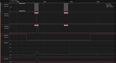

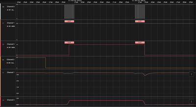

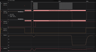

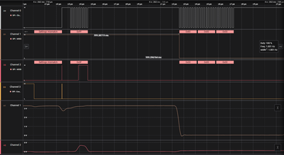

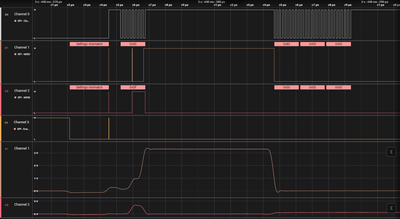

I checked the SPI signal on the steval mki109v3 with a logical analyzer and found several odd things but the sensor is answering
I don't know if it is my analyzer but the MISO line is always stuck at 1 and the level of MOSI are strange but the sensor understand the message and answer with the right value (WHO_AM_I register:  MOSI should send 0x0F and MISO answer 0x70)

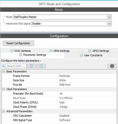

On the other end I tried to recreate the same configuration on my nucleo board but the sensor doesn't answer any command
I tried:
full duplex master CPOL=1 CPHA=1
with external pull up on MISO
full duplex master CPOL=1 CPHA=0
I tried in master half duplex
I tried master half duplex with CPHA =0 (1 edge)
