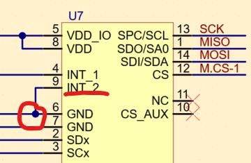

Hi, in my application I will not use INT2 pin. Is it okay to connect INT2 pin to the GND?0693W00000aJTRmQAO.jpg

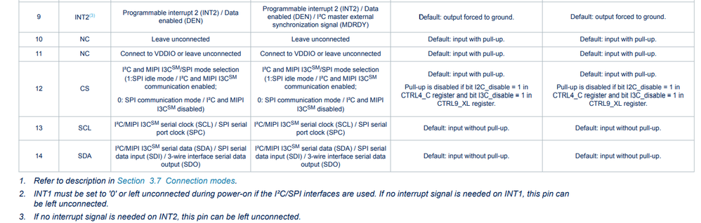

Hi @Eleon BORLINI​
https://www.st.com/resource/en/application_note/an5473-lsm6dso32-alwayson-3d-accelerometer-and-3d-gyroscope-stmicroelectronics.pdf
According to this application note, INT2 default is output forced to the ground
0693W00000aJkQMQA0.pngso Is it okay ?

Eleon BORLINI
Hi @Egemen​ ,
yes you can, INT2 is by default in high impedance state.
-Eleon

Hi @Eleon BORLINI​
Eleon BORLINI
Hi @Egemen​ ,
you are right, in my mind I was thinking that could be left unconnected, and I wrote high impedance.
It is ok as well.
-Eleon
