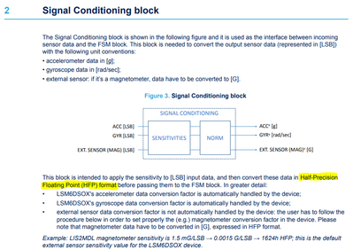

As written in the AN5273 the FSM works in floating point on 16bit:

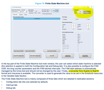

For the conversion you can use Unico GUI or MEMS Studio:
