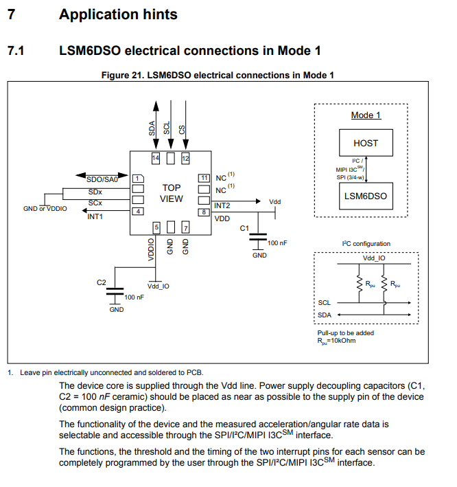

​hi Gabriel, did you follow all the Mode1 electrical connection suggestions?
And is this error still related only to RS14100 device? Could you set 8bit communication instead of 16bit on your master?
