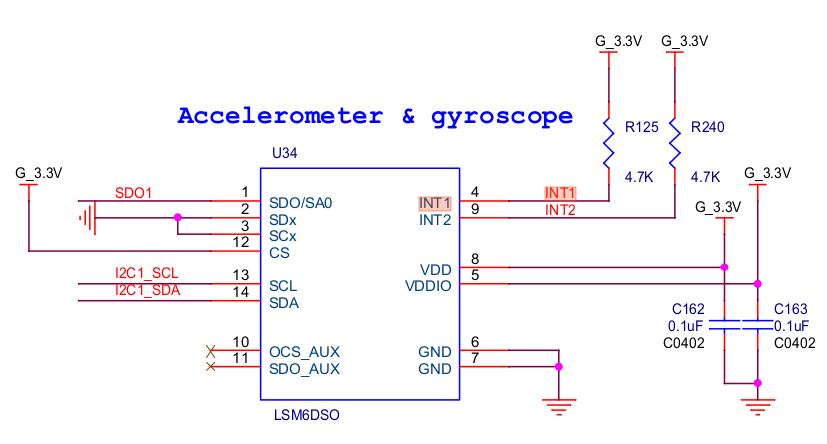

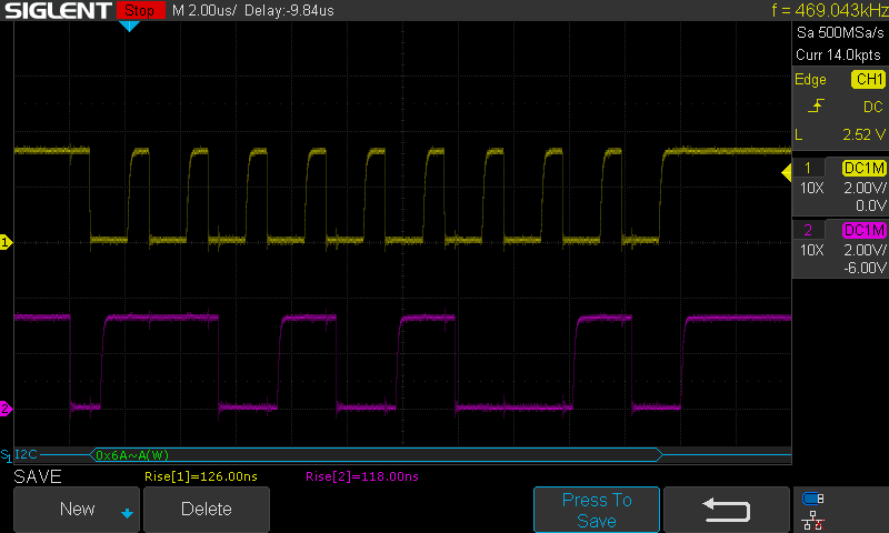

The LSM6DSO instead does not reply, there was an error in the schematic because there was a pullup resistance on INT1 that has been removed, so the sensor should correctly run in I2C mode. But it does not. SA0 is on GND, so it should reply to the address 0x6A, but it is not possible to read the WHO_AM_I register (see attached picture).0693W00000FDBjNQAX.pngI tried to change the configuration of the INT1 pin on the MCU, leaving it unconfigured, setting it as output pin in push-pull mode with and without pull-down, and I also tried to set it as open-drain, but without success.
Do you have any clue about the possible causes of this problem?
Following the schematic of the circuit, R125 and R240 have been removed, SCL and SDA have 1k pull-up to 3V3:

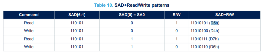

Please note that the full I2C address has to take into account also of the R/W bit, so the complete address in your case (in order to read the WHO_AM_I register) is D5h.
0693W00000FDJwZQAX.pngThe schematic looks otherwise ok. Can you try with this?

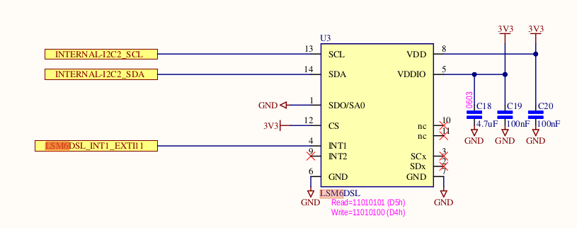

@Eleon BORLINI​ I used the LSM6DSL of the IoT Node Discovery Kit and on its schematic, the pins SCx and SDX are floating. We connected them to GND as suggested on the datasheet... is it possible that they should be left floating instead?

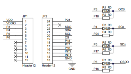

Note that with the LSM6DSL you have to consider the following connections (datasheet, p.20):

We are using an LSM6DSO, I posted the picture of the LSM6DSL because I used it in my preliminary tests on an IoT Node Discovery Kit.
LSM6DSL and LSM6DSO are very similar and both datasheets say to connect SDx and SCx to VDDIO or GND, but on YOUR devkit they are left floating and that devkit works as expected.

Both on STEVAL-MKI196V1 (adapter for the LSM6DSO) and on the STEVAL-MKI178V1 (adapter for the LSM6DSL), that are the reference kits for ST IMU sensors, the SCx and SDx pins are intended to be connected to the application processor, so they are kept in a known condition.
