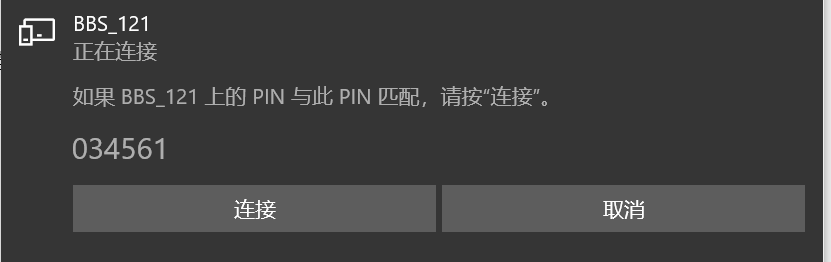

2021-10-26 12:48 AM
I use folder en. Fp-sns-stbox1_ firmware_ Bin in blesensors in v1.3.0,
when I try to connect the sensorfile. Box with the computer Bluetooth through ble, and then use the unicleo GUI tool.
The problem shown in the figure below always fails, but I don't know how to fix the pin code as 123456.As you said, “you can use Unicleo-GUI tool to acquire sensor data from the Sensortile.box via BLE on your PC.�?, How to solve this problem?please give me some feasible help.Thank you.
2021-10-26 3:13 AM
Hi @jiazi.1hao ,
The storage of the data can be done "automatically" in the SD card of the Sensortile.box, and can be configured through the application. If you however want to store the data in the PC, you have use the capability of the specific OS to store the data streamed on USB or BLE. For example, here below a simple description to save a Teraterm log:
About the BLE pairing, you cannot connect the Sensortile.box to the smartphone and to the PC at the same time, since you can pair only two devices per time. You might have to clear the Bluetooth whitelist on one device before connecting it with the other device. Pairing code is always 123456.

2021-10-26 4:35 AM
"Yes it is possible. you can use Unicleo-GUI tool to acquire sensor data from the Sensortile.box via BLE on your PC."I want to ask you about the deeper meaning of this sentence in the previous answer. I don't understand what you said. Can you say your meaning in more detail? thank you
2021-10-27 2:45 AM
Hi @jiazi.1hao ,
I'm sorry, using Unicleo-GUI is only possible to acquire data via VCOM using the DatalogExtended example in the fp-sns-stbox1.
In order to acquire sensor data via BLE on your PC, you should use the STBLE Sensor apk on Github (link), running it on your PC with Android studio and setting the BLE communication with the SensorTile.box in this way.
Maybe there are other more general BLE GUIs to do it, but I'm not an expert on this.
-Eleon
