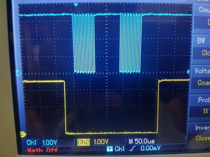

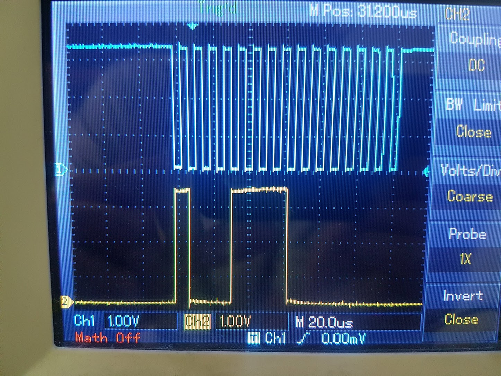

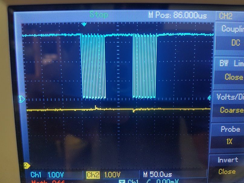

Hi @Yiftah , ok I understand... when you write >>SPI signals look fine in the oscilloscope, which is the pattern on SDO_Aux pin? Regards
2020-04-16 1:28 AM
Hi @Eleon BORLINI ,
SCLK (pin 3) + MOSI (pin 2):
SCLK (pin 3) + MISO (pin 11):

2020-04-16 4:57 AM
Hi Yiftah, also MOSI output seems not good... can you check the standard SPI communication between the master NUCLEO-G071RB and the slave STEVAL-MKI196V1? Are you correctly managing the CS pin? Maybe is not an issue of the aux interface but of the SPI at master level... Regards

Hi @Eleon BORLINI , can you please give more details what exactly is wrong with the MOSI signal?

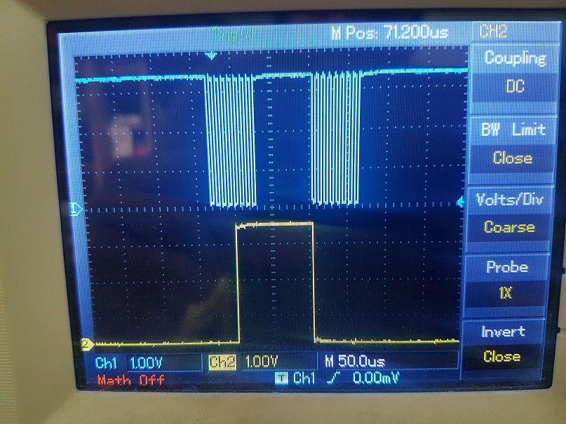

2020-04-19 7:12 AM
More information about the issue:
I noticed that in Figure 8 in the DS the first bit should be high for reading, so I added "| 0x80":
#define LSM6DSO_REG_WHO_AM_I 0x0F
while (1)
bufp[0] = LSM6DSO_REG_WHO_AM_I | 0x80;
status = HAL_SPI_Receive(&hspi1, bufp, 2, HAL_MAX_DELAY);
}Now this is the MOSI signal:
But there is no change in the MISO signal - always HIGH :weary_face:
I also tried to disconnect the MISO from the master, connect only to the oscilloscope, and enable/disable the pull-ups with PIN_CTRL (02h); but MISO is not changing (with pullup - always HIGH, without pullup - always LOW).
