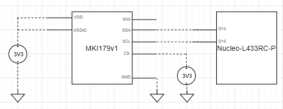

I let you my schematic:

Hi @Community member​ , did you place the pull-up resistors on I2C SDA and SCL lines? You can also check if you structured well your project by checking the STM32CubeL4 function package examples for Nucelo-L433RC (folder \Projects\NUCLEO-L433RC-P) from MCU side, and the X-CUBE-MEMS1 function pack (folder \Projects\STM32L476RG-Nucleo\Examples\IKS01A3), from LIS2DW12 MEMS + STM32L4 family side. Regards
MAndr.233
Associate III
Thank you for the response,
Yes I already tried with pull up resistors and the result it's exactly the same. I was wondering if I have to initialize device in some way. But following the example in Driver's example it seems that nothing is initialized.
