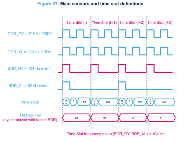

(timestamp - (2U * TIMESTAMP_FREQ / (uint32_t)bdr_gy));If you choose the same Batch data rate [Hz] for both accelerometer and gyroscope, you'll capture and store data at the same time so you'll have the same timestamp.
An example of the timings between data is described in the application note AN5192, p.94:
However, for a more detailed question I suggest you to post it in the "Issue section" on Github, that is periodically updated by ST experts.
