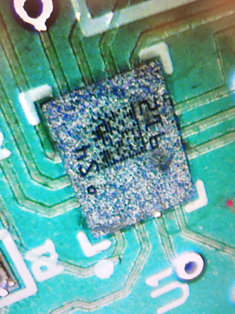

YRakh.1
Associate II
0693W000001s6i1QAA.jpg0693W000001s6hwQAA.jpgthanks for the quick answer! here are the images:
Thank you @YRakh.1​ . Please condider the two-digit marking near the pin1 dot indicator
  • marking S0 --> LSM6DSOX device
  • marking S4 --> LSM6DSO device
Regards

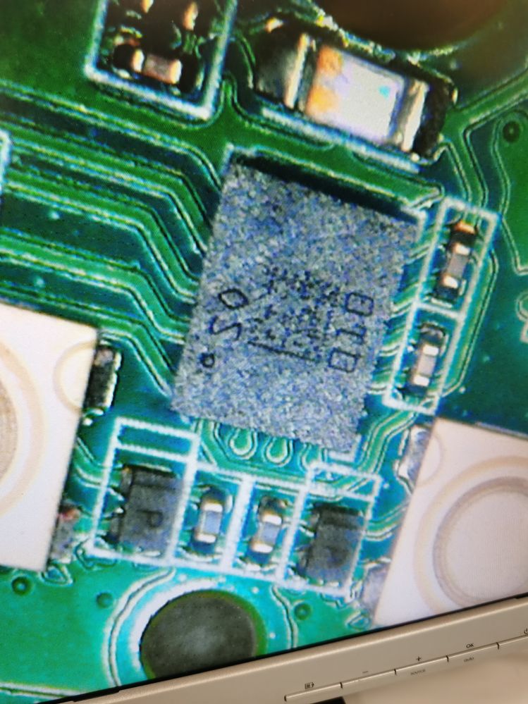

Mmm.. are you sure? i just checked STEVAL-MKI197V1 with LSM6DSOX and on this chip label is S4, but it is 100% LSM6DSOX (if datasheet is ok)
here S4 label:0693W000001s8RbQAI.jpg
probably you messed up the labeling?
Sorry, I have confused. The progression 0-->4 indicates the part number evolution
STEVAL-MKI197V1 --> LSM6DSOX --> S4
STEVAL-MKI196V1 --> LSM6DSO --> S0
regards
