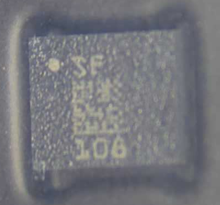

Our incoming inspection unit failed to find any information on LSM6DSLTR device marking. We got parts with 2 lines on it.
SF
2D code
106
Could you please confirm it is a LSM6DSLTR device? Is there date code on it?
2023-02-20 5:32 AM
Yes, SF designates the LSM6DSL.
The date code is given in the last line, 106 stands for 2021, week 6.
Does it answer your question?

2023-02-20 5:32 AM
Regards
/Peter
