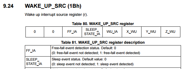

This is inherent behavior of the sensor. The interrupt is generated when the sensor enters to inactivity mode and also when it escapes from this mode.
You can check the if the sensor is in inactivity mode by reading SLEEP_STATE_IA bit in WAKE_UP_SRC register.

Thanks Miroslav, I didn't know that's how it behaved (don't see that in the datasheet).  I'll perform a read to check the sleep state.  So to be clear, when I get an inactivity interrupt (after the device has become inactive) it will be asleep and I should expect the SLEEP_STATE_IA bit to be high, correct?
Posted on August 28, 2017 at 13:40
Yes, your understanding is correct.

Thanks for the app note - that is very useful.  I also tried reading the register and it works as expected.
