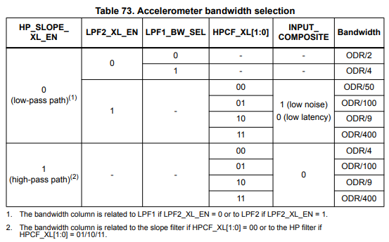

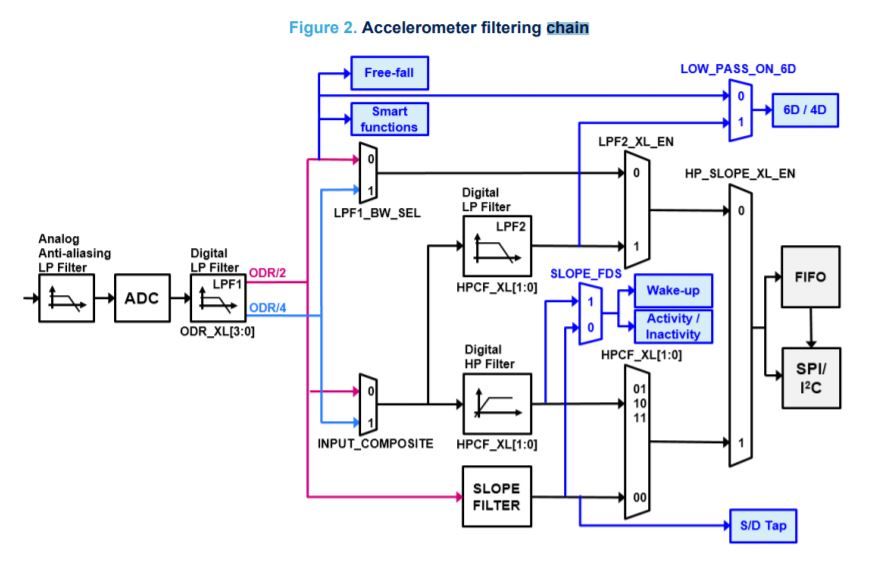

hi David, the first LP filter (not considering the anti-alias) is configurable in CTRL1_XL (10h) reg and CTRL8_XL (17h), especially in the CTRL8_XL (17h) reg:
to have the lowest roll-off frequency you have to select the ODR/400 case, meaning value b1011000 (58h) in reg CTRL8_XL (17h). If you set ODR below 416Hz you'll have a LP cutoff frequency < 1Hz.
