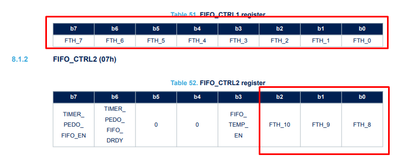

To set the threshold, you need to write the bits FTH_[10:0] in the FIFO_CTRL1 and FIFO_CTRL2 registers that contain the threshold level and then write in the register INT1_CTRL = 0x08 to route signal on INT1 pin and enable gyroscope and accelerometer in FIFO writing to FIFO_CTRL3 register.

For 06h and 07h, I'm writing these bits so that I have a 12-byte threshold.
