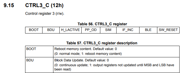

Hi @GRagh​ , I don't know if I'm catching the point... You are filling the FIFO in continuous mode and, when the threshold is reached, the data are read in MSB+LSB pr in multiple MSB and multiple LSB mode... right? Did you maybe set the BDU bit in reg CTRL3_C (12h)?
