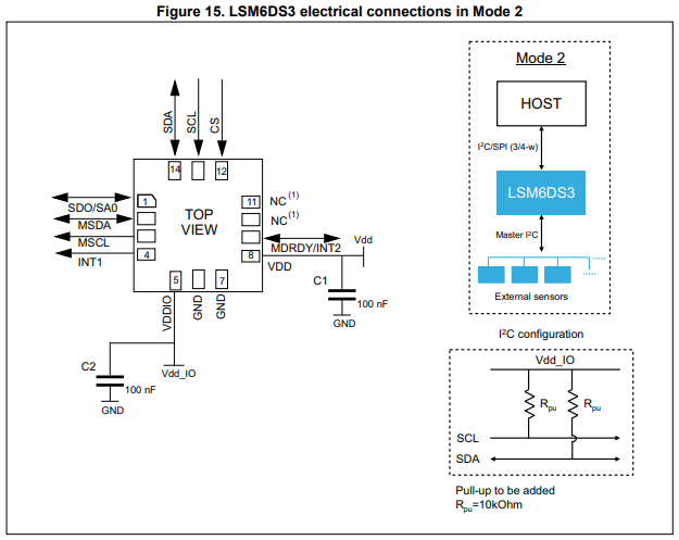

Hi @Community memberrivetskov , there is an example on Github (HERE) that may fit your case.
The file is specifically this one: lsm6ds3_sensor_hub_lis2mdl_lps22hb.c
I suggest you to check also the hw specifications for the connection of the LSM6DS3TR with sensor slaves ("Mode2"): you can find them in the datasheet p. 42.
