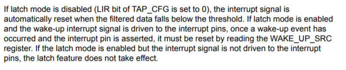

I am a little confused about the TAP_CFG LIR bit not affecting the wake/sleep interrupt because in AN4650 Section 5.3 (Wake Interrupt) this behavior is specifically mentioned.
Is this an error in the app note or am I misinterpreting what this paragraph means?

The LSM6DS3 has two features, which I think we are mixing together.
1) Wake-up interrupt described in chapter 5.3 of the application note AN4650. (MD1_CFG = 0x20) This interrupt can be latched.
2) Activity/Inactivity recognition interrupt described in chapter 5.6. (MD1_CFG = 0x80) This feature is also able to generate interrupt when the device goes to sleep mode and wakes up but these interrupts cannot be latched.
So I think you are using the second feature - Activity/Inactivity - and in this case the interrupts cannot be latched.
