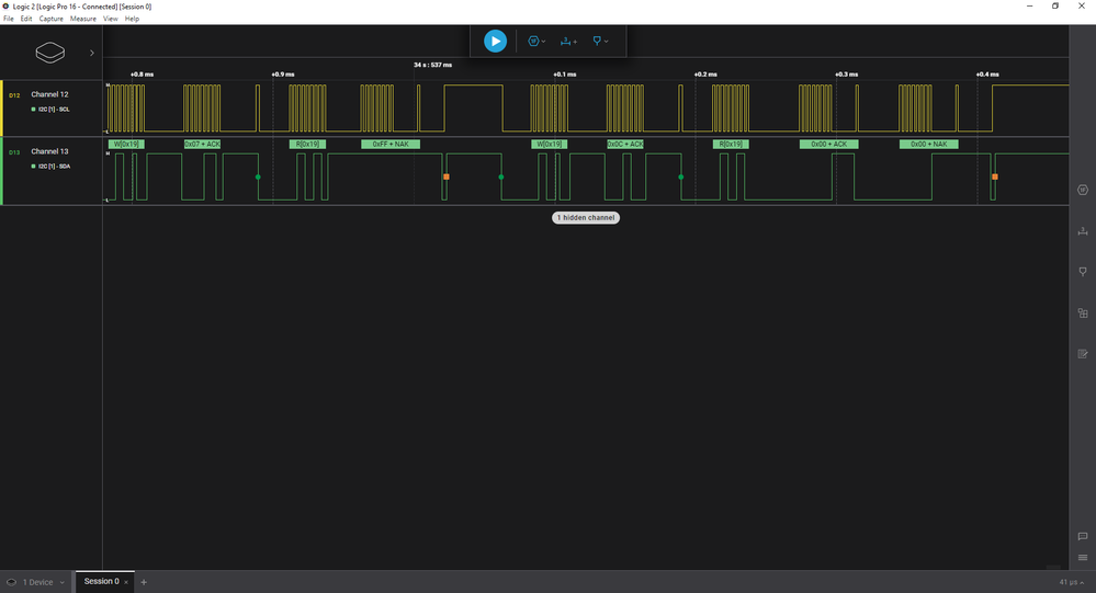

When I display the I2C signals, it seems to be correct :
If you have some suggestions, I'll be very happy.

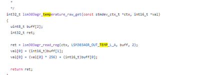

Did you set the TEMP_EN[1:0] bits to 1 in the TEMP_CFG_REG_A (1Fh) register?
You could also take a look at our PID examples on Github.
You will find how to read the temperature sensor output and how to implement it:
