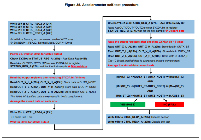

I am having a hard time understanding the Self test procedure. Is it possible to get a simpler procedural explanation?

Hi @MV.1​ , as a general note, did you already check the self-test procedure described in the AN4825, p.63 (or equivalently in the device datasheet)?

Hi @Eleon BORLINI​ ​ , we are struggling to solve the accelerometer self-test constant failure. We were referencing AN4825 self-test routine flow. We are facing this issue on three different boards. Besides, results depend on board orientation. Could you assist?
static uint8_t LSM303AGR_selfTest(int vendor)

Hi @KLise.1​ , are you facing the issue always on the X axis or this is random? Did you discarded the 1st sample data as described in the flow? Regards
If the board is in one position, then only X-axis fails. If orientation changes, then it could be two axes fail or only Y-axis.
Yes, as you can see in the code above.

Ok thank you. Can you check your code with the lsm303agr_self_test.c C example for LSM303AGR, available on Github, if not already done? Regards
Unfortunately, already has been done, but had no luck :( Shall check once more.
