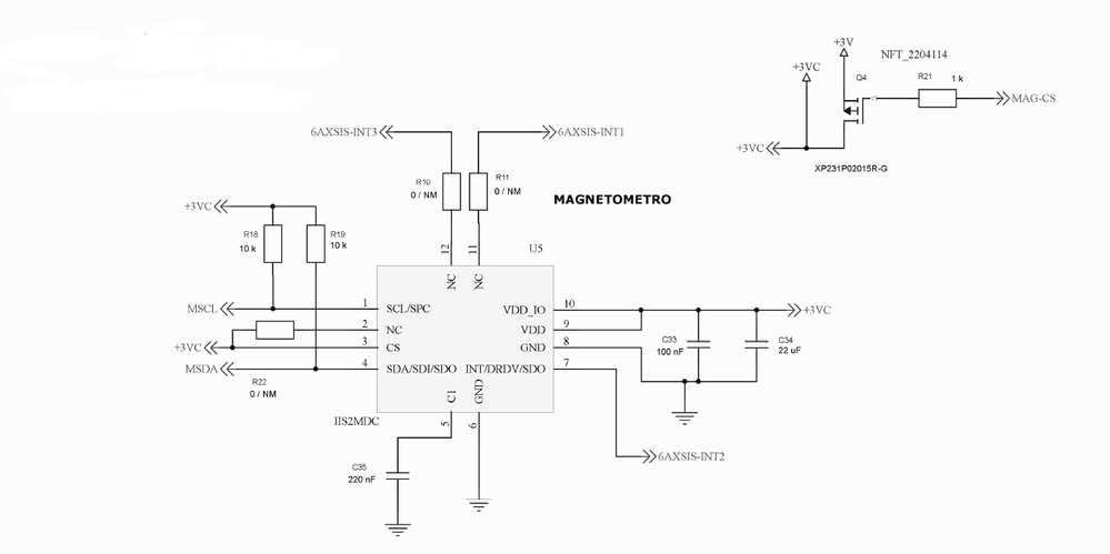

Ok, can you share your board's schematic?

This is the schematic. Don't pay attention to the fact that IIS2MDC is written there because the board provides the possibility to mount this component too.
The power is supplied through the Mosfet Q4 to have the possibility to completely switch off the component when not in use.

Federica Bossi
Hi @CSharpino​ ,
The schematic seems ok, what you could try is to reverse commands like this:
