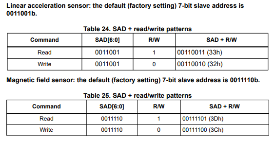

Hi @HIngv.1 ,
When you set the magnetometer configuration and hard-iron compensation you use ACC_ADDR instead of MAG_ADDR. Please, try to use MAG_ADDR as described in Table 25 below and let me know if you fix the problem.
