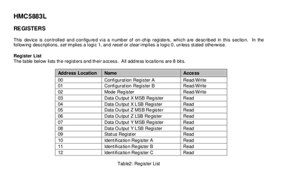

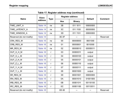

LSM303 :
And HMC5883L:
The LSM303 has an additional accelerometer, and those registers are located at higher addresses.
The magnetometer section of both is so far identical - although some parameters are not, it seems.
At least the maximal update rate of the magnetometer data is different (200Hz vs. 75Hz).

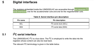

And, there is this peculiar statement in the datasheet (DocID018771 Rev 2) :
There is just one I2C interface presented to the outside, one SDA and one SCL pin.
