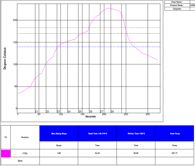

We can provide the temperature profile used by our subcontract, here attached. That is compared with standard JEDEC profile:
Hope this helps.
