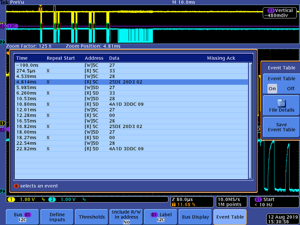

Below is a list of the readings of one board, sensor 1 then sensor 2 pressures, taken about 1 second apart. Note that although both sensors are reporting varying data, only sensor 1 is reasonable. Temperatures for bad devices report some 20 degrees below where they should (this can be seen in the I2C event table below.)

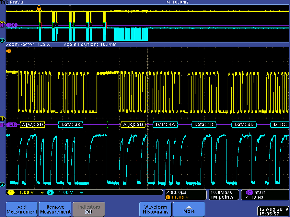

The sensor reporting good data (976xxPa at address 1011101x)

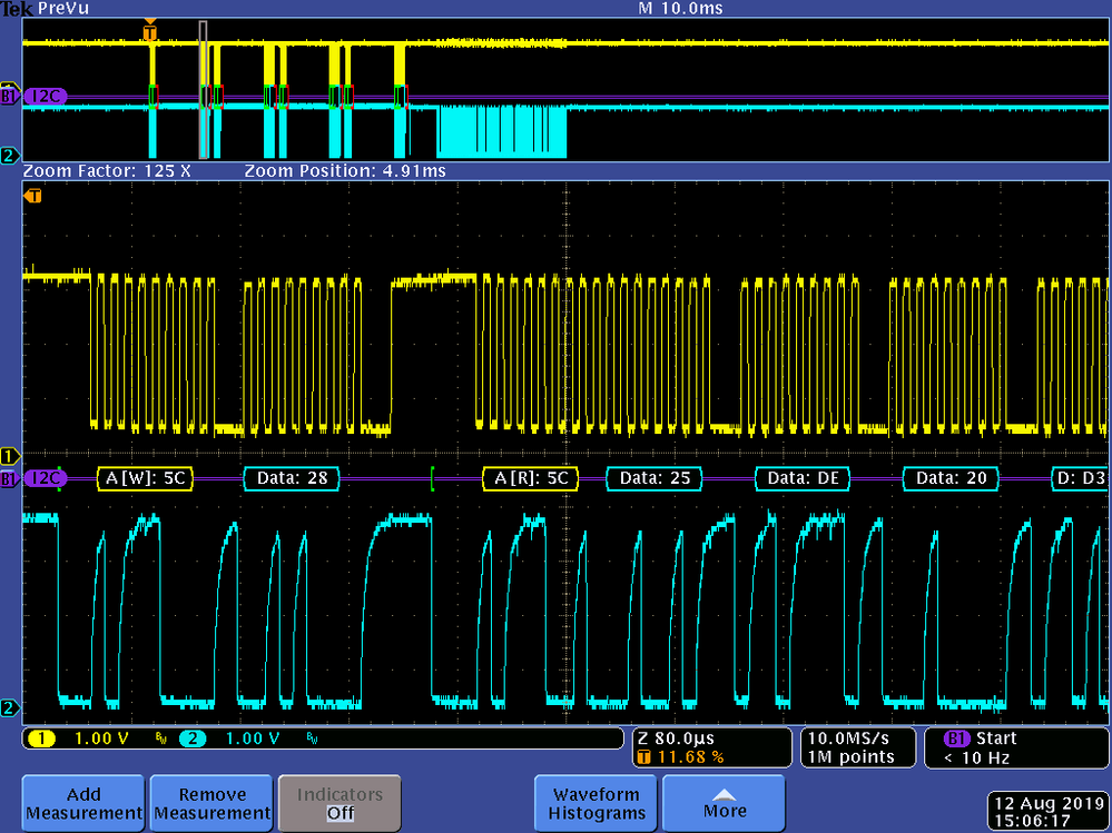

Sensor reporting bad data 525xxPa at address 101100x)
I2C transactions as decoded by the scope:
