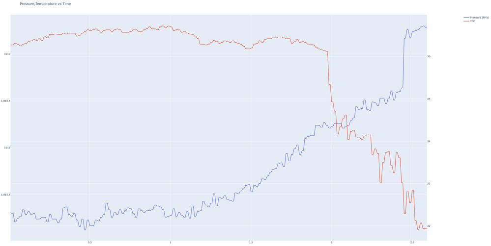

I have made a custom board with lps22hb. I am trying to get accurate pressure but it fluctuates with time. As I plotted a graph showing pressure and temperature I figure there is a direct relationship. I think that according to the datasheet, it should be accurate at +/-0.1hPa between 0-65°C. So is my sensor damaged? or there is a temperature compensation to make?
During the test, the board was on my desk measured at 28°C and then on a table outside measured at 20°C. Pressure scale on the left, Temperature scale on the right and Time in hours.

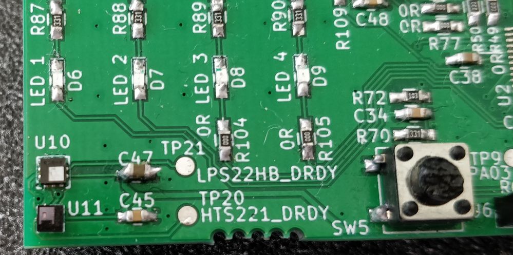

It has been soldered by hand on a custom PCB and a stencil. The soldering process was done with reflow oven. Reading the datasheet I see how critical is this process. I have a STEVAL-STRKT01 with the same component. I will manage to make a test and let you know.LPS22 is component U10 on the board.

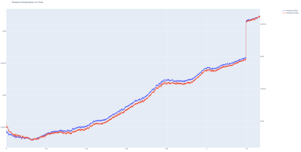

With steval-strkt01 with LPS22 I have better results. Looking at nearby airport Metar the pressure increase from QNH=1017 to 1019 during the test (40m AMSL):
made an other test simultaneously with 2 ms5611 (without temp):
All sensors showed a good accuracy knowing the envirenmental pressure increased by around 2hPa.

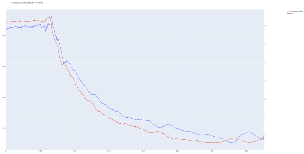

The sudden decreasing temperature with steval-strkt01 is me opening the box because it was slightly warmer than my desk because of battery charging. The pressure is not following the temperature like in first graph.
