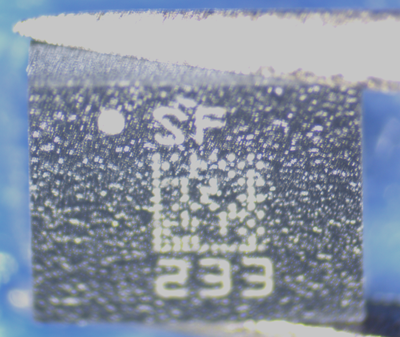

I am looking for a part marking for LIS3MDLTR. The part says SF 233, but am unsure if this is the correct marking. I have read ST does not post their part markings externally.

SF is the marking for the iNEMO IMU LSM6DSLTR, not the magnetometer LIS3MDLTR.
Regards
/Peter

Welcome @SMG-Andre, to the community!
the LIS3MDLTR is marked with the three letters MDL, arranged one below the other on the left.
Hope that answers your question?
Regards
/Peter
Hi @Peter BENSCH,
Thank you for the reply. Our quality inspector found this and has sent me this image.
SF
(dot matrix code)
233
This part was purchased from Digikey. It does not have 'MDL' written on it.
Peter BENSCH
Regards
/Peter
