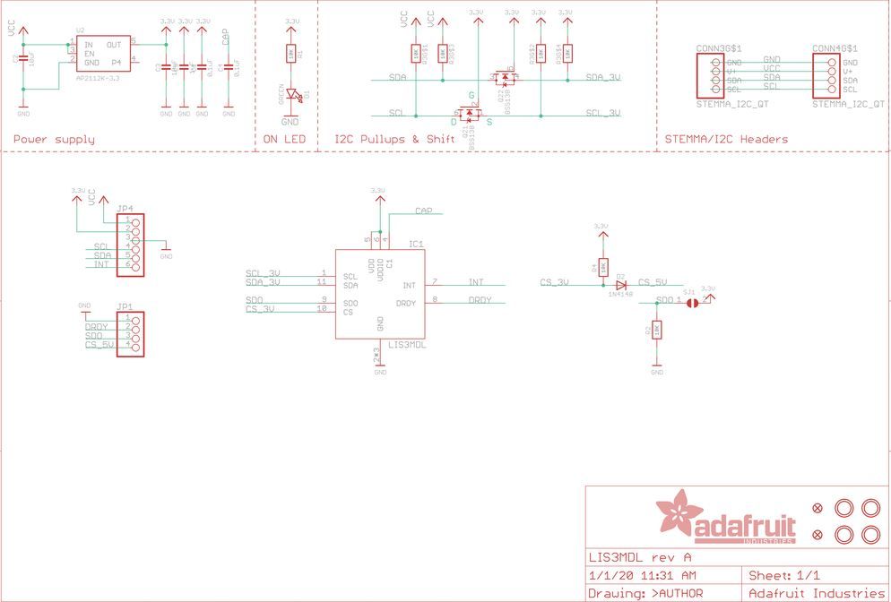

2021-05-17 3:50 AM
Hi Eleon,
We are using adafruit module for testing purpose only and their schematic is shown below
SDO is connected to GND in our case.
Once we are happy with the current consumption then we are planning to add into our final project.
Regards
Siva
2021-05-17 4:36 AM
Hi Siva @SKund.1 ,
it looks ok.
Did you measure the current consumption from the device Vdd only (without any other devices connected?)
And could you please unsolder the R2 resistor and connect the SJ1 solder bridge and check again the power down consumption (no SPI running, and register not configured, right?)?
-Eleon
