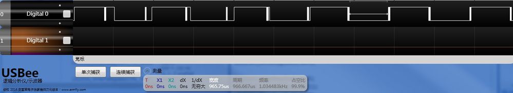

lis3dsh-interrupt-state-machi2016-03-08 2:05 AM
the INT1 logic output:
