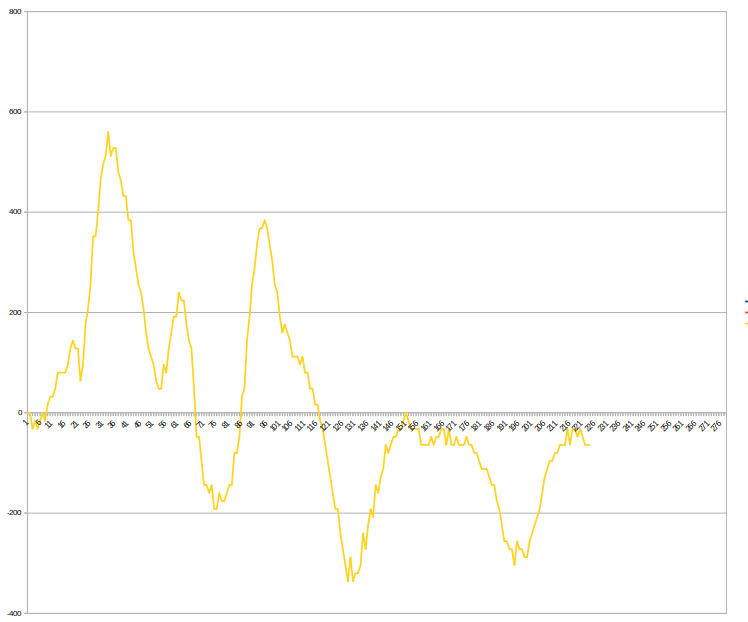

0693W000006FKsMQAW.pngHello
I am using the LIS3DH to detect an impact on a vehicle. Our layout does contain only one interrupt pin, so I have to switch during the event.
Init:
  • Clear all registers
  • CTRL_REG1 (400Hz, XYZ enabled)= CTRL_REG1_ODR2 | CTRL_REG1_ODR1 | CTRL_REG1_ODR0 | CTRL_REG1_XEN | CTRL_REG1_XEN | CTRL_REG1_XEN
  • CTRL_REG2 (HP filter for interrupt and output buffer = CTRL_REG2_FDS | CTRL_REG2_HP_IA1
  • CTRL_REG3 (interrupt IA1) = CTRL_REG3_I1_IA1
  • CTRL_REG4 (+-8G) = CTRL_REG4_FS1
  • INT1_THS (504mg) = 0x08
  • INT1_CFG (enable xyz interrupts) = INT1_CFG_YHIE | INT1_CFG_XHIE | INT1_CFG_ZHIE
  • CTRL_REG5 (enable FIFO) = CTRL_REG5_FIFO_EN
  • FIFO_CTRL_REG (watermark 16, stream-to-fifo )= 16 | FIFO_CTRL_REG_FM1 | FIFO_CTRL_REG_FM0
  • read REFERENCE_ADDRESS
I build a pendulum to have a predictable signal. This seems to work well as I do get an interrupt:
  1. Interrupt received, read last 32 Samples in FIFO
  2. Change interrupt to watermark
  3. read 14 times 16 samples when watermark interrupt occurs
  4. Change interrupt to threshold
This seems to work quite good, as I get the amount of data I am looking for.
But the data I do receive is not looking as I expect, there is nothing that looks like a pendulum and it does have spikes in it.
Can somebody tell my where I do have an error in my procedure?
Kind regards
