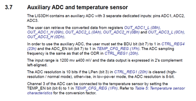

Kindly provide the details of raw sensor data interpretation method/ formulae to equate for getting the required data

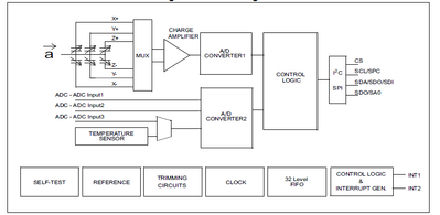

As per the below block diagram the temperature sensor is connected via ADC3 channel higher register, so able to read the raw temperature adc value from this register.

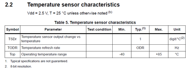

2. To convert the Temperature sensor output value to temperature conversion – the below is the table given in the data sheet.

Able to read the data in the OUT_ADC3_HIGH(0Dh) register. The value read from the
register is 7. But my room temperature is 24.7°C.
What is the offset value or any process has to be done to get the actual temperature value.
