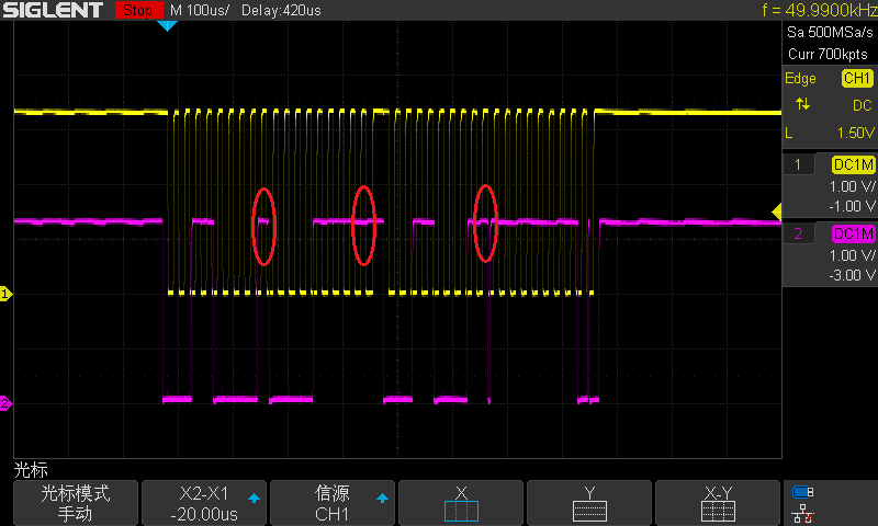

I am using LIS3DH accemelator to acuqire gravity data. The MCU is NXP MKL16. LIS3DH's pin8 CS is set to high level to communicate with I2C protocol, and pin7 SA0 is set to connect to GND. The SCL and SDA pins are pull up with 4.7K resisttors. After setting the MCU's I2C port with 50KHz communication speed, and try to read WHO_AM_I register of LIS3DH, the value return is 0XFF, which is not correspond with 0X33. Then I use an oscilloscope the capture the signals on Lis3DH SCL and SDA pins. The signals can be seen from the picture. It seems that the acknowledge is not received at the 9th clock pulse, which is conflict with the LIS3DH's datasheet. I have spent plenty time to make LIS3DH to work correctly, but in vain.

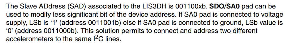

Thanks for Andrew's suggestion. But after carefully check, the Slave Address and sub register address seems right. As the slave address presented in LIS3DH datasheet, with SA0 pin connected to GND, 7bits slave address is 0011000b, the SDA signal of the first byte, the LSB bit is I2C Write bit. NXP MKL16 writes a byte with MSB first, the same with LIS3DH, the justify doesn't seem to be a problem.

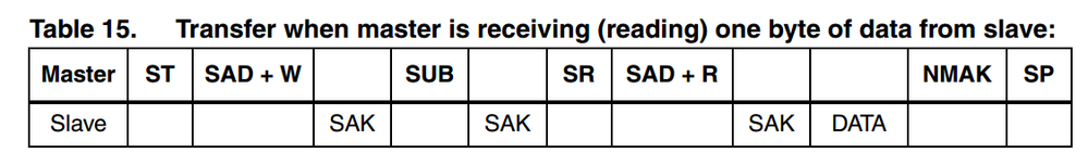

The sequence of read a byte is correspond with the datasheet.

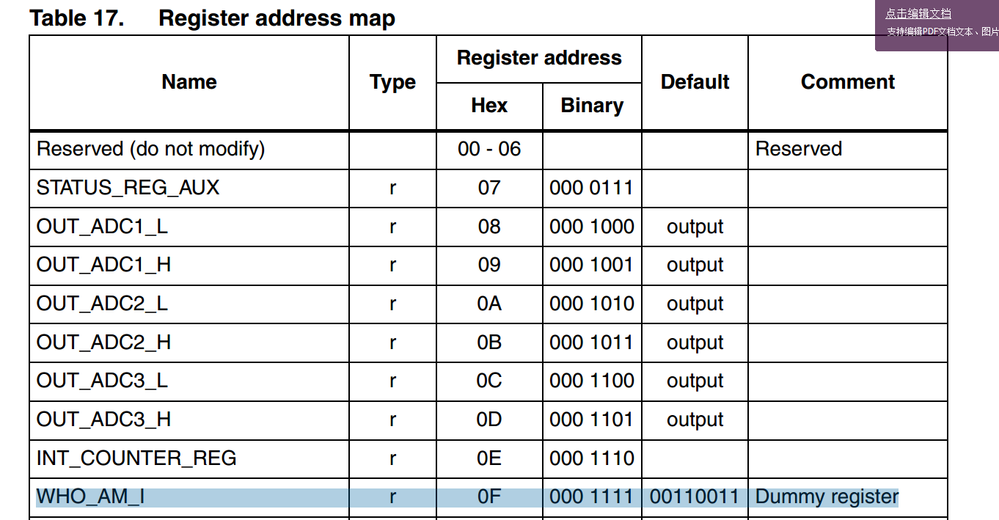

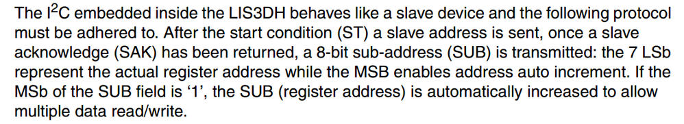

The WHO_AM_I register address(bit0-bit6) is 0x0F according to the datasheet, only one byte is readed, so the MSB bit (bit 7) is set to 0b, the SUB is also right.
But LIS3DH don't give SAK at 9th clock pulse for three times. Any possible cause? Thanks!
