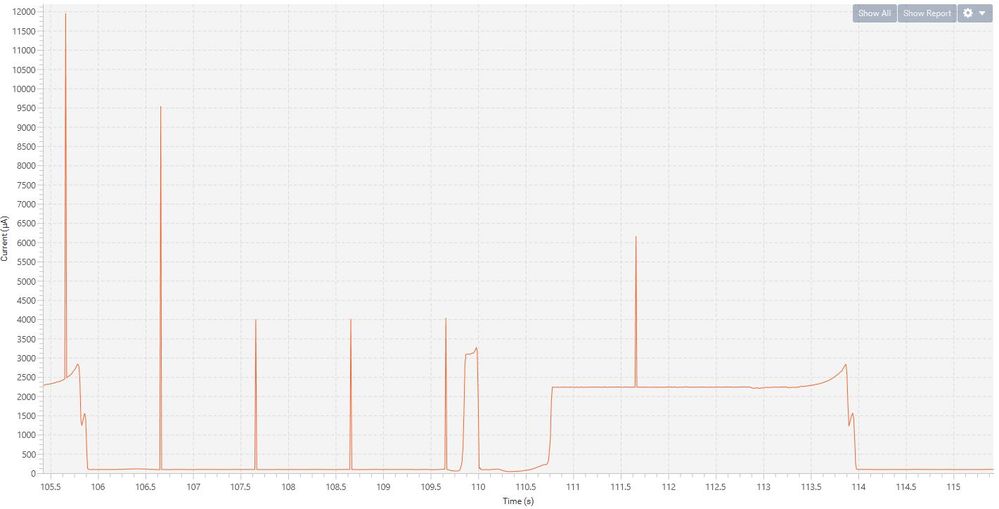

Image with square wave excursion is with the LIS2MDL active, LSP22HB in idle mode, and LSM6DSOX in low power accel only mode (gyro powered down) after no motion detect.

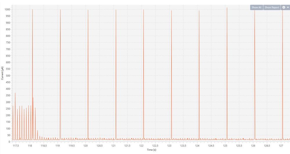

Image with just sharp spikes is LIS2MDL power down and LSP22HB active with accel/gyro in same state.
So, could LIS2MDL interrupt pin connected to INT2 cause this odd current excursion? Could it be something else?
