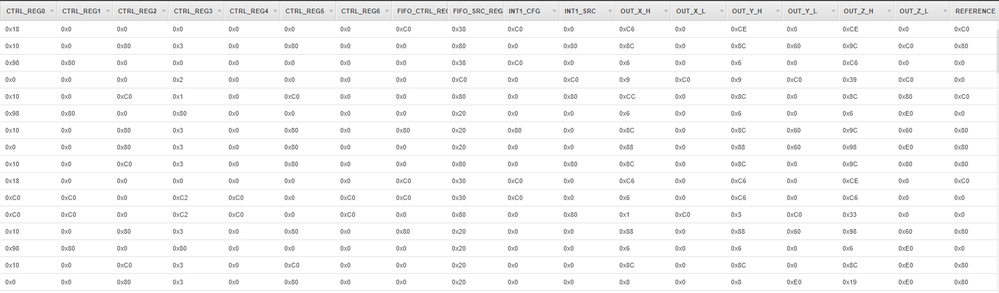

Got lis3dh and lps22hb on the custom board with F411 MCU. Use FIFO modes with both sensors. After getting interrupt on INT1 (lis3dh) and DRDY (lps22hb) pins MCU executes samples reading using DMA. Also got mutex for handling SPI bus access.

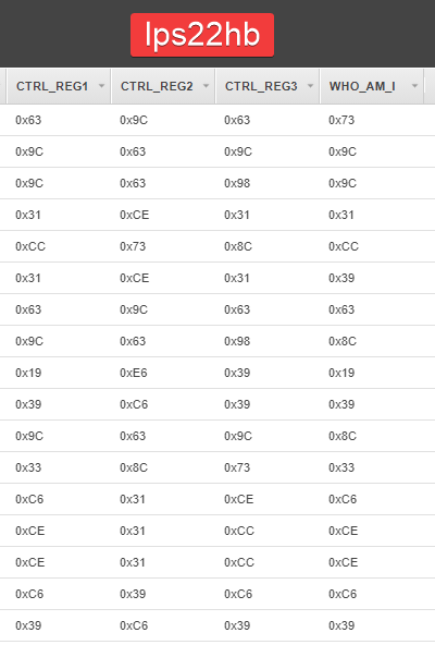

Ok, after power ON the board everything works fine for weeks or even months, but sometimes after MCU reboot (cause of IWDG or hard fault or because of fw update) sensors stop working and when reading a set of registers I receive strange data. Please, refer to the pictures below. Each row of the table corresponds to what was read from the sensor with an interval of 30 seconds.
I've read data sheets and application notes many times and am aware of reboot, reset and other features and commands that might be used in despair with this undefined behavior. Only device power off helps.

focusing on the data in the registers, there seems to be a problem in the communication.
the WHO_AM_I register cannot change its value, so the problem is not in the sensor itself, but in the communication.

Regarding register values that I'm getting from the sensors - if you take a closer look at the values you'll see that they are repeated, and is there a chance that cause of system reboot (which probably interrupt DMA transfer) sensor would stay in the state where it's expecting to only transfer data and ignore read/write cmds? Maybe because of the mechanism that increments address during FIFO buffer read process I just continue reading FIFO buffer that had place before MCU reboot?

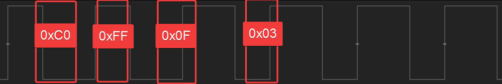

d) So I start sending and receiving bytes without selecting any device, and find out that I receive not 0xFF, but a variety of values. Then I increased the communication baud rate (f(pclk)/256 -> f(pclk)/16) and the values start being with one 'F' or zero, like 0xFF, 0x1F, 0x00, 0xF0.
e) Yeah, as I mentioned earlier I got the ability to remotely reboot the device (therefore and SPI and DMA modules too) and I did it many times to see any progress.
f) I meant that for example if you look at the lps22hb values in the table above, then at least two of the registers' values are equal. In d) point I mentioned the results using higher SPI baud rate.

So basically I got some signal on the bus that corrupts the data during transfer. So the picture below illustrates what I said earlier about received data with the higher baud rate:
I capture fronts, ends or either the body of the pulses. But I don't understand - what's the source of these pulses. I don't select any device, and there's nothing in the code that could use SPI bus, except the disabled sensors related routines. Could you please advise if the sensor (lis3dh or lps22hb) at any condition could drive MISO line, even if it isn't selected by master?

The picture in my previous message is just the attempt to interactively display what is happening on the MISO line and not the capture of the data line of the troubled device.
