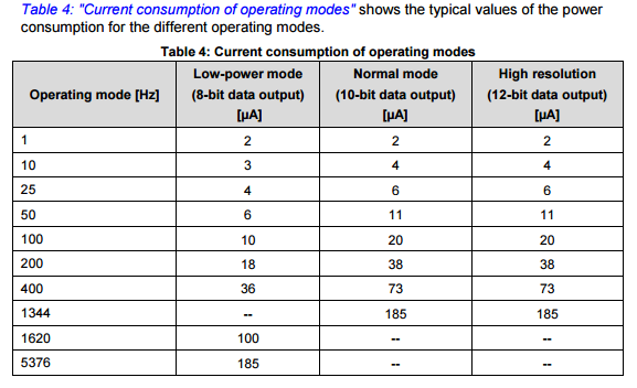

For current consumption please check the following table from application note.
2017-05-25 8:36 AM
OK, what I wanted to say is: The free fall abuse allows me to stay at 1Hz low power all the time, which results in 2 uA overall power consumption, regardless of activity or inactivity.
The Actvity/Inactivity detection as outlined above _automatically_ stays at 10 Hz low power, which means 3 uA in inactivity phases.
