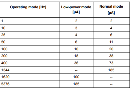

Thanks, I did fear that this might be the answer since it doubles the amount of data that i have to transmit via I2C. another question very closely related to this: The LIS3DE also has a 'normal' mode (vs. 'low-power') but always delivers 8-bit values - is there really any difference between these two?
On the LIS3DH the device provides 10 bit in normal mode (instead of 8 bit). The only option affected by this setting on the LIS3DE is the 1.6 kHz mode - is this correct or is there any other use of the normal mode on the LIS3DE?
Posted on June 19, 2018 at 16:40
First difference is the available ODR modes:
Second difference is in current consumption:
In Normal mode the noise will be lower because the sensor does internally an averaging.
