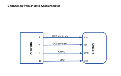

We are using the LIS2MDL magnetometer sensor in the I2C connection on the xilinx zcu106 evaluation board, which we are connecting to i2c0.

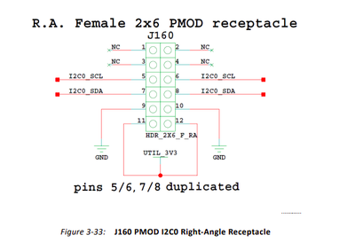

From the ZCU106 user guide, J160 pin,
https://www.mouser.com/datasheet/2/903/ug1244-zcu106-eval-bd-1596082.pdf
