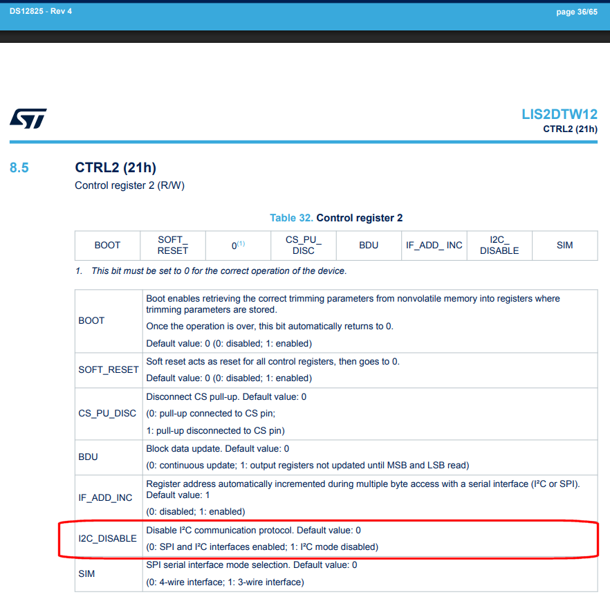

@Garslanbay wrote:
 I haven't been able to read the NRF24L01+ registers at all.
Can you communicate with it on its own - ie, with the LIS2DWT12 disconnected?
You can disable the I2C in the LIS2DWT12:

But I couldn't get it to work. I know that different models exist, and I adjusted accordingly. The common pins like SCK, MOSI, MISO are the same. I haven't been able to read the NRF24L01+ registers at all.
I had this thought: could it be that when I set the CS pin of the LIS2DWT12 sensor High, it switches to I2C and is preventing my communication with the NRF?
Ohh thank you so much i will try it than i will give information about this subject.
