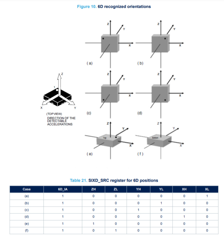

the fact that -in the first batch of samples- you have the X_L=1 (and all the other SIXD_SRD relevant bits = 0) and in the next slot the Y_L is =1 (and all the other SIXD_SRD relevant bits = 0) means that -during the time in which the first FIFO batch has been acquired- the device position was (a) (with reference to the above picture), while in the second FIFO run it was rotated as in (b).

Hi @Msaga.1 ,
if both the bits are raised this means that acceleration in both direction has crossed downwards the Threshold value [in degrees] defined in the 6D_THS[1:0] bits of the TAP_THS_X register, according to the application note p.23.
If these bits have been set to '11', the threshold is 50 degrees and so the movement will be in diagonal. If it is '00', there has been an external acceleration -probably- both along X and along Y, since in this case the threshold value is 80 deg that is close to 90 (i.e. 1g gravity acceleration)

The last sentence refers to the condition in which there are no external forces acting except the gravity: in this case, especially if the 6D_THS[1:0] bits are at 00h, you'll experience the threshold crossing only on 1 axis. On the other ones the value will be always under 1g.
But in the case your device is receiving an external force additional to the gravity, of course the threshold can be overcome in different directions.

Hi @Msaga.1 ,
in case the device is stationary, it will not be possible to have more than 1 bit raised.
If you however rotate the device, in the next FIFO batch a new flag will be raised, and the previous one set to 0.
Hope this will clarify better.
