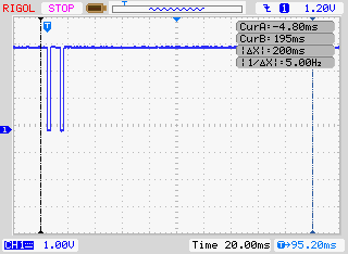

I'm working on enabling single tap detection on LIS2DW12. I found it generates multiple interrupts for one single tap. After I check the signal on oscilloscope in one of the single tap event, the 2 interrupts are seen within 20 ms which I should have 30 ms quiet period set. Can you please check how to configure the sensor properly to avoid this? Thank you.

Scope view:

Thank you. I tried to disable LIR on CTRL3. The behavior did change. I saw the interrupt latched to whatever quiet time I set. Does that mean even after I clear the interrupt by reading the register, the interrupt pin will stay until the quiet time finished?
Are you suggesting when in latched mode, the same event could generate 2 interrupts? (e.g. the first pulse in the screen shot is the first time single tap event is recognized. Driver clear the interrupt, and the second interrupt coming in right away because of the quiet time has not finished yet.)

I don't know how to explain the 'double' interrupt. According to AN5038 section 5.6.2, quote:
"In particular, after the first tap has been recognized, the second tap detection procedure is delayed for an interval defined by the quiet time. This means that after the first tap has been recognized, the second tap detection procedure starts only if the high-pass filtered data exceeds the threshold after the quiet window but before the latency window has expired."
I really don't know how to explain where the second interrupt came from. These 2 interrupts are shorter than the quiet time I set. If it is really came from the other event, I really need your help to identify it.
