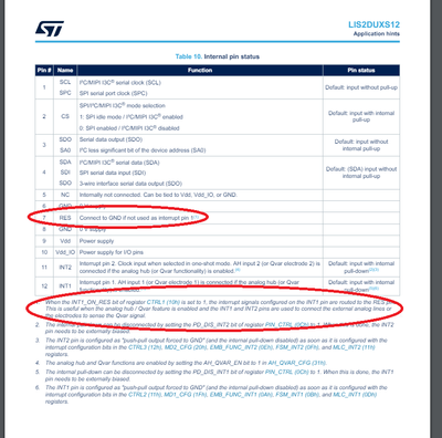

Hi all,
I am trying to implement the  LIS2DUXS12 into a design and I am wondering if it is possible to still use the interrupts while using the Qvar sensors. Ideally, I need a way to detect when the device is on the human body and also a way to wake up MCU when motion is detected. It appears this isnt possible with the Qvar leads taking up the interrupt lines.
Will this be possible with this device?

Hi @Eyurk ,
Welcome to ST Community!
Yes it is possible. You find all the details on datasheet at page 17:
