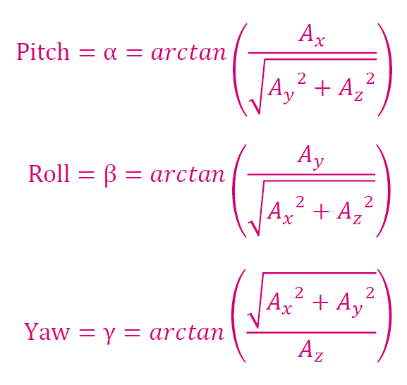

For a project, I am trying to get the tilt angle of the device measured in degrees with a value between 0 and 360. At the moment, however, I'm not succeeding and looking on the internet I found this documentation:
Do you have any code to which I can get information for this problem? I tried to use equation 2 but it doesn't give me back the angle. I also tried equation 6 but it doesn't work.

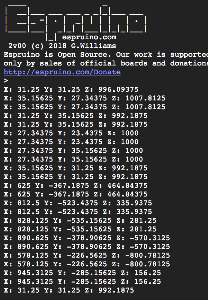

The values I can take from the accelerometer are values in mg.
Here is the photo:
Do you know how to help me?

These formulas works for range -90° to +90° in all three angles:
For Pitch you can use other formula for range -180° to + 180°:
Pitch = arctan2 (Y/Z)
2018-10-29 5:54 AM
2018-10-29 6:21 AM
Hi Miroslav, thank you very much.. It seems to be working properly!
In order to make that I used:
pitch = (((Math.atan2(accelerationY,accelerationZ) * 180) / 3.14 ) + 180 );
By using the AccelerationY and accelerationZ provided by the device, than converted in degree and "+180" offset to get values from 0 to 360.

In a static situation, angle of inclination (pitch in this case) is calculated right. Could you explain please the math behind this calculus? Why it works? Specifically, I did not quite understand how the accelerometer values are turned into an angle. I know the interpretation of the atan2 function, but I do not understand how the vectors detected by the sensor are then interpreted in a goniometric circumference and turned into an angle. I can not base myself on what I read in your datasheet:
For example, I get a pitch of 103,94 if I get values y: -0,980 and z: 0,244 with accelerometer with a face towards me, so:
Thanks!
