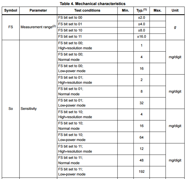

3. Convert the raw data into g unit value using sensitivity for selected mode and full scale. The sensitivy value can be found in Table 4 in datasheet.
x = x_raw * sensitivity ... value will be in mg (milli g)

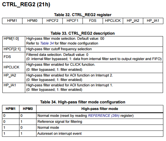

For that case you can use high pass filter. You can enable high pass filter for output values and/or for interrupt generator.
Reading REFERENCE register in Normal mode you can set the ''0,0,0'' position and then evaluate only the differences.
2017-06-07 5:46 AM
If you want to see the output after the high-pass filter you have to set the bit FDS = '1'.
To reset the high-pass filter by reading reference register you have to set
HPM[1:0] = '00', but I think in your case the normal mode
HPM[1:0] = '10' is also possible to use.
2017-06-07 6:49 AM
Then, I should write on CTRL_REG2 a 0x81
NORMAL MODE IN HPM[1:0]
FDS 0
HPCLICK 0
HP_IA2 0
HP_IA1 1
And then, read REFERENCE(0x26) register to set up 0,0,0, shouldn't I?
Is this correct? Because I tried and I still get x,y,z values as before. Is this ok?
