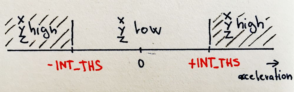

The treshold is absolute value. So the high interrupt means that the absolute value of acceleration is above the threshold, low interrupt means the absolute value of acceleration is bellow the treshold. Following picture might help.
In your case onlu high interrupt needs to be enabled.

Many thanks for your fast reply and the great image!
Now I understand what is meant with the low treshold correctly!
